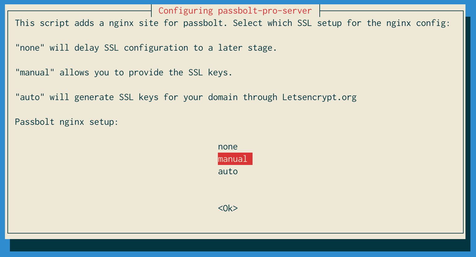

Choose ‘manual’ for the TLS (SSL) setup method:

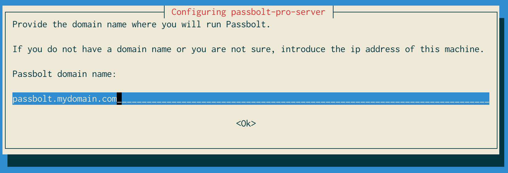

Provide the domain name you plan to use for your passbolt server. On this example and as we are using a self-signed certificate the domain name is not as important as if you are planning to use a proper TLS (SSL) certificate. In the later scenario DNS domain name and TLS (SSL) domain name must match.

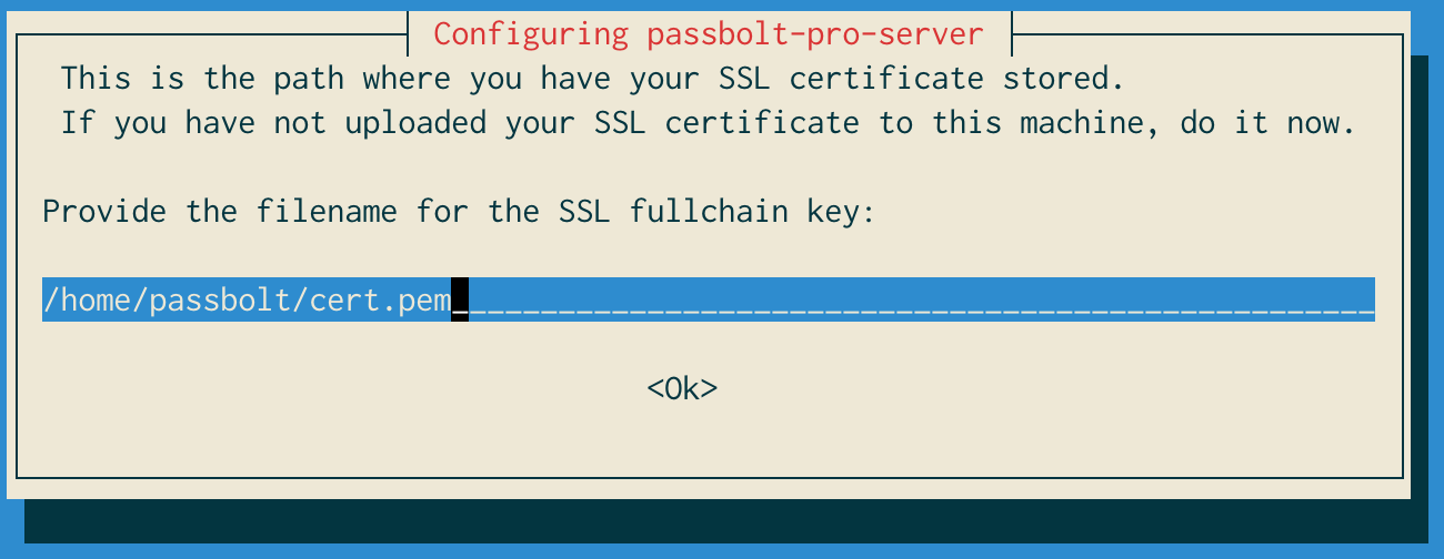

Provide the full path of the TLS (SSL) certificate you created on previous steps: cert.pem

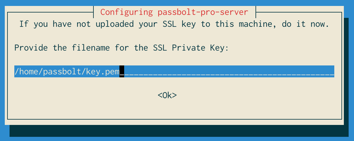

Now provide the full path of the TLS (SSL) key: key.pem
The certificate's private key should not be passphrase-protected so that the web server can read it.
