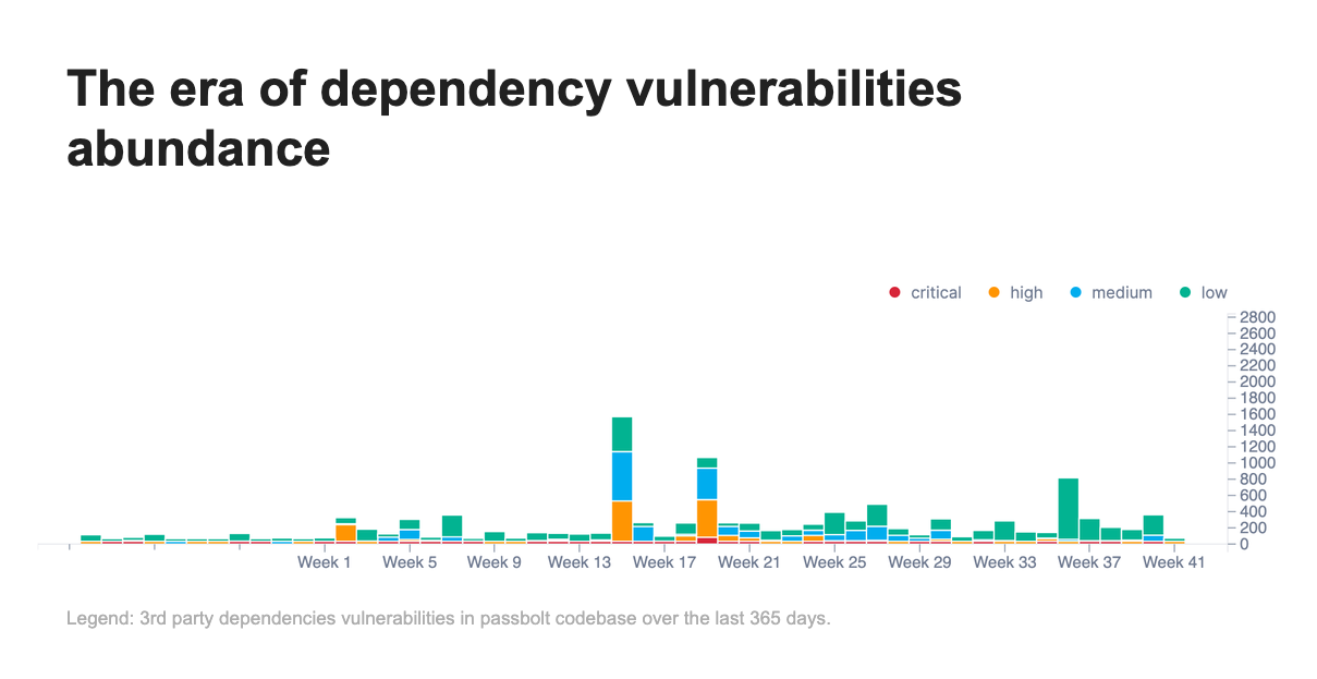

In practice, this means that the barriers to entry for mounting a cyber attack, or even just discovering a vulnerability, have dropped dramatically, both in terms of the skills required on the part of the attackers as well as in the amount of time and resources necessary to prepare an exploit. But fixing vulnerabilities still happens at a human pace.

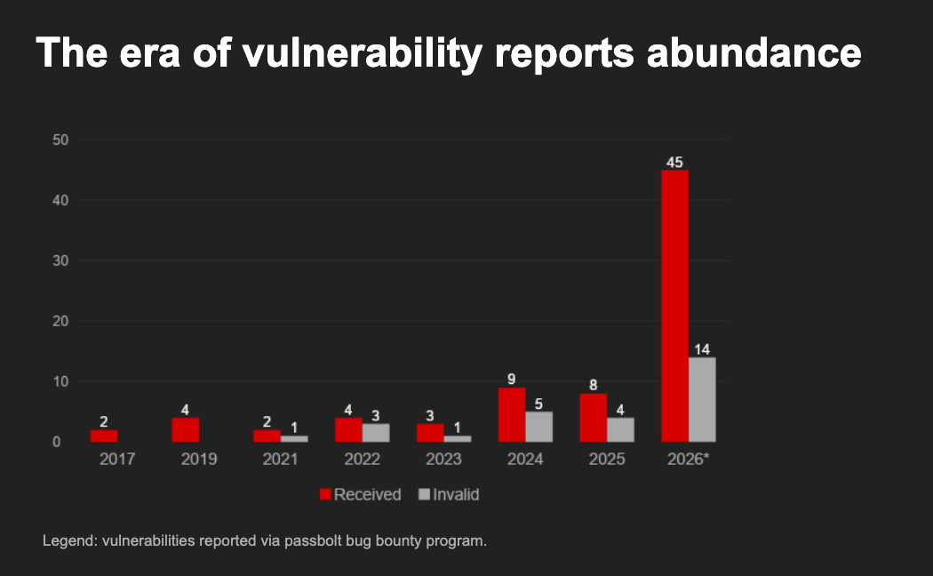

For companies like Passbolt that take security seriously, the need to thoroughly review code before any new features ship has always slowed down feature delivery to a certain extent. The current environment is a double whammy when it comes to productivity compared to less security focused companies. First of all, the flood of security vulnerabilities means that much more time is spent working on the fixes compared to developing new features. At the same time, Passbolt engineers have the same review processes on new code as before, so the productivity increases from AI on new feature development aren’t that big.
When it comes to the security vulnerabilities, though, there’s some hope of a light at the end of the tunnel. At some point, if you fix all the security issues, you should get to a point where you’ve fixed everything. “At some point, it will go down,” said Stéphane Loegel, Product Software Engineer, about the number of security issues he’s dealing with. But that certainly hasn’t happened yet, and the process is painful. “We had a period where we were, maybe not paralyzed, but the team I was working with had to slow down a lot because there were a lot of things to review.”
Passbolt already had a tight security posture, but the flood of AI-related vulnerabilities has forced the team to tighten the security posture even further. First of all, they’ve reduced the attack surface by aggressively reducing the number of dependencies, which means there are fewer places that vulnerabilities could pop up and a lower risk of a supply chain attack. Being frugal about dependencies has always been part of Passbolt’s security strategy, but it’s something they are even more aggressive about now.
The team is also more aggressive about proactively scanning for vulnerabilities inside the dependencies that can’t be eliminated, so that they proactively fix them. This, incidentally, is a situation where AI is useful — the team is able to make use of generative AI’s strength in finding vulnerabilities and fixing them before the code is pushed to production.
