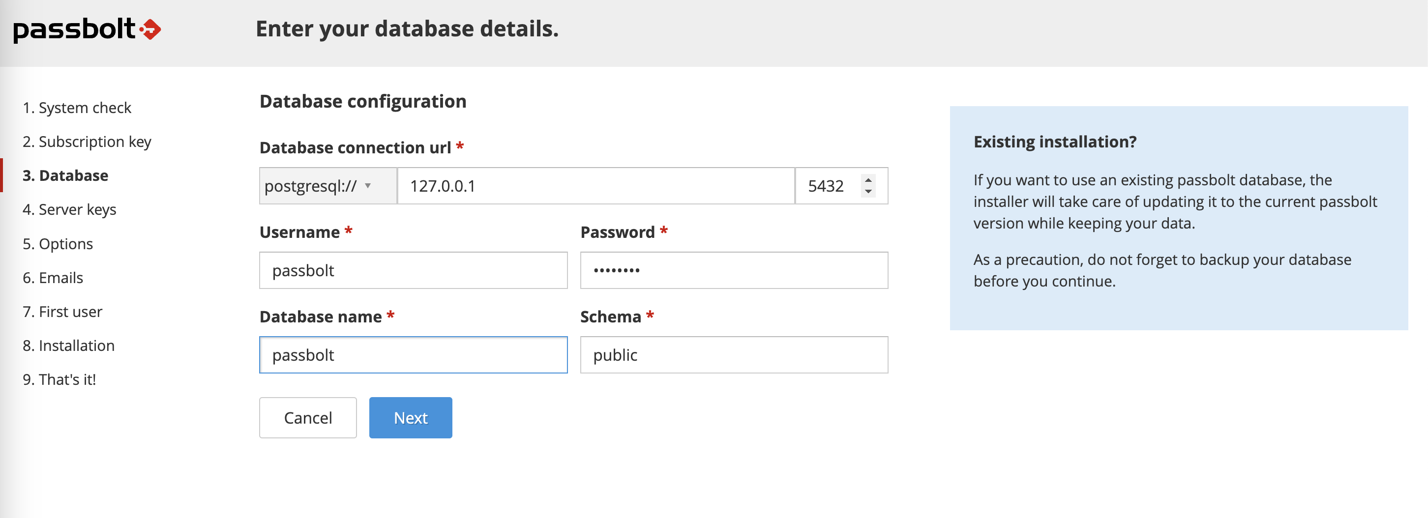

You will need to navigate on your browser to the URL of your passbolt instance, from there, you will be able to configure the database section with Postgres instead of MariaDB.
Configure Postgres on the webInstaller
fig. Configuring Postgres on the webInstaller
