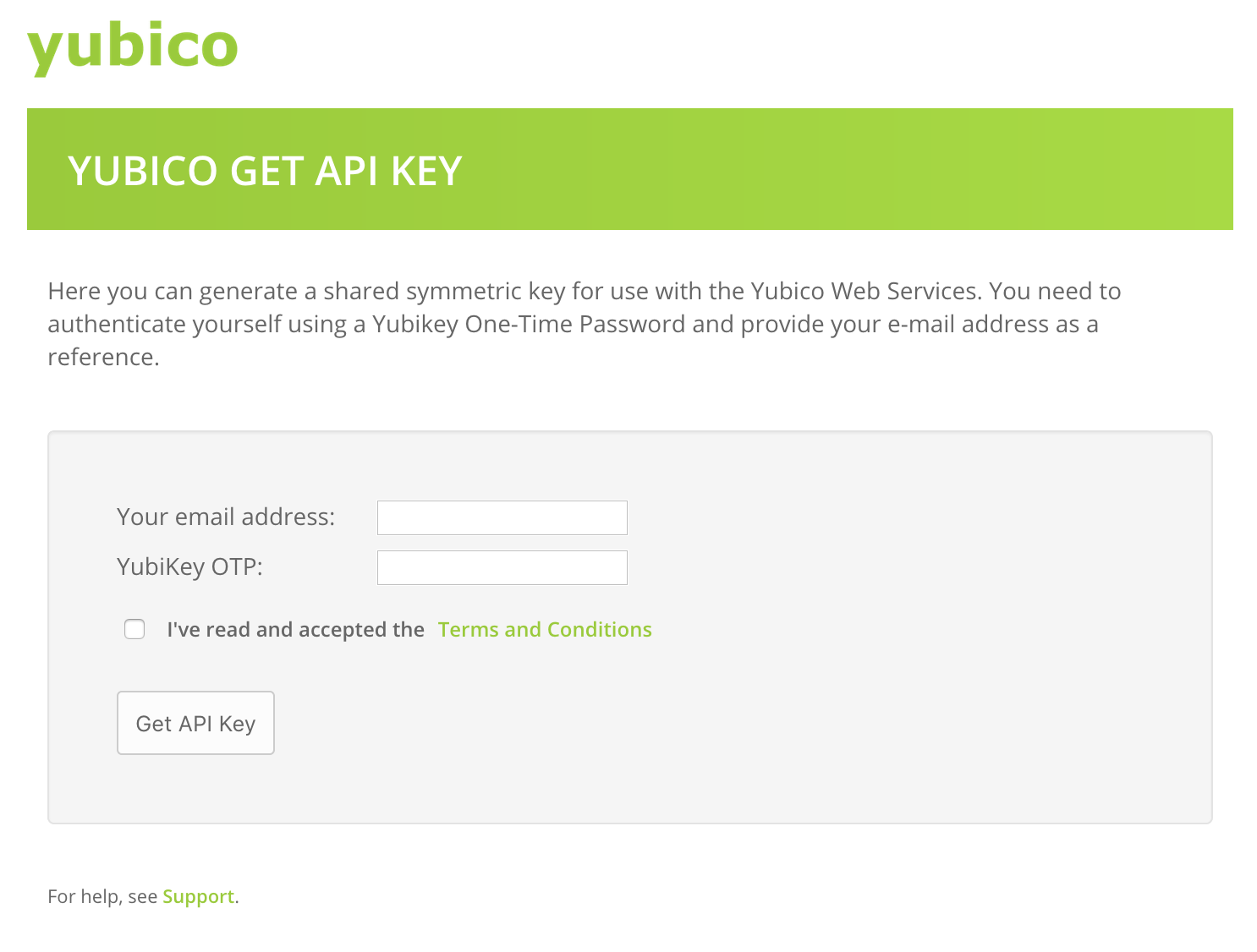

Register to YubiCloud
In order to use YubiKey to authenticate to passbolt you first need get an API key for YubiCloud, Yubico’s web service for verifying one time passwords (OTPs).
Navigate to upgrade.yubico.com and signup to the service using your email and your Yubikey.
Please note that it is no longer possible to host yourself the OTP validation server.

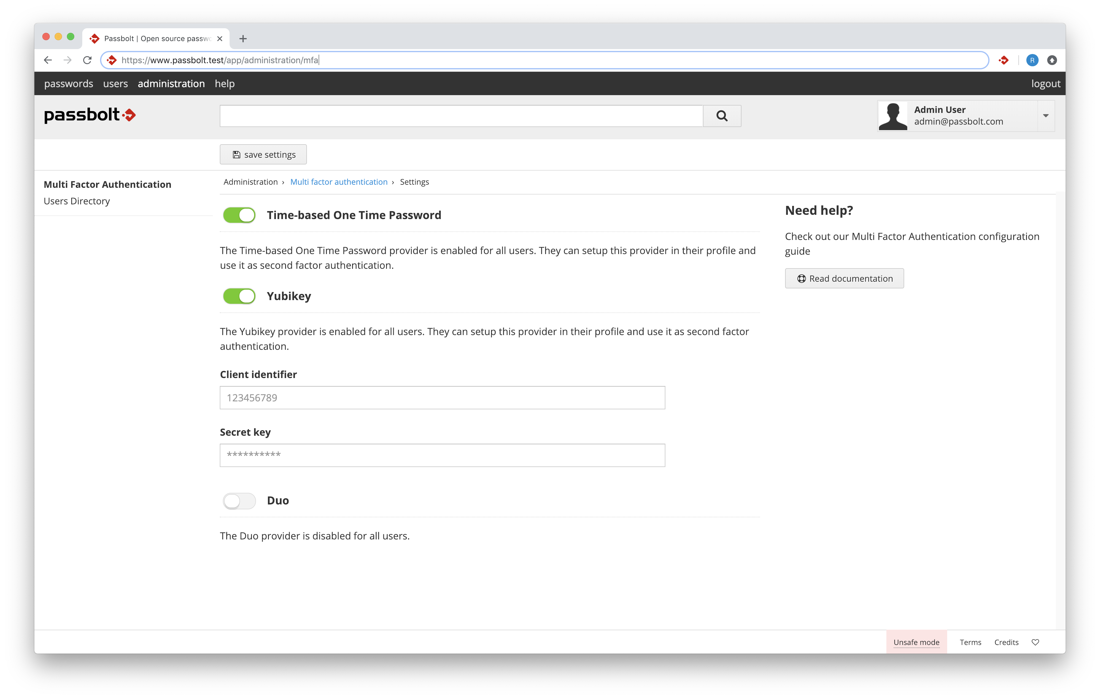

Enable Yubikey access
Yubikey can be set up through either the administration interface or environment variables. Should both settings providers be utilized, the configurations made in the administration interface will take precedence over those specified by environment variables.

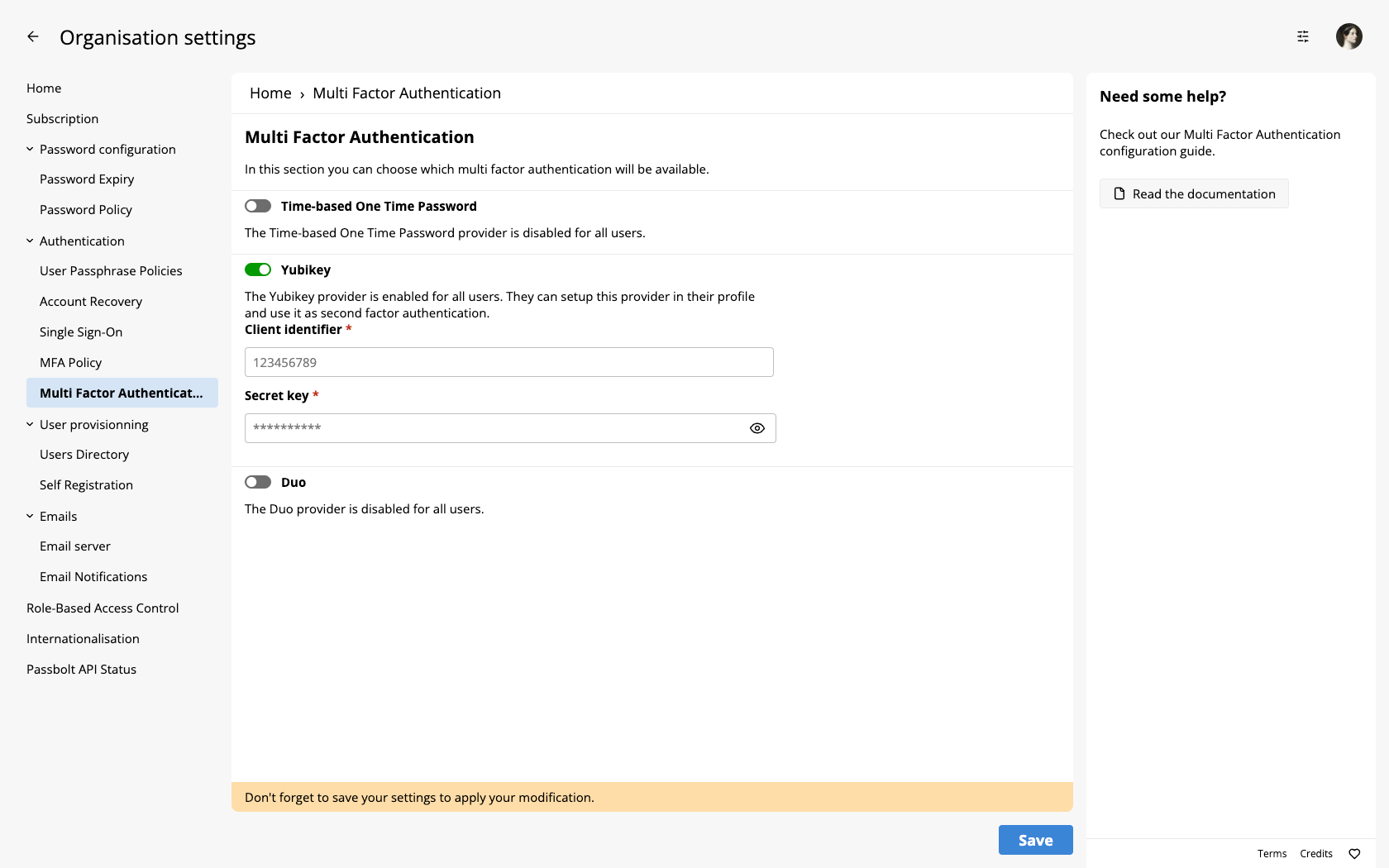

Enable Yubikey access via the interface
To enable YubiKey via the interface, navigate to the multi-factor authentication administration page: Administration > Multi Factor Authentication.
Subsequently, enable the "YubiKey" provider by moving the adjacent toggle to the on position and inputs the information provided by YubliCloud at the previous step. Ensure you save these modifications to activate the provider.

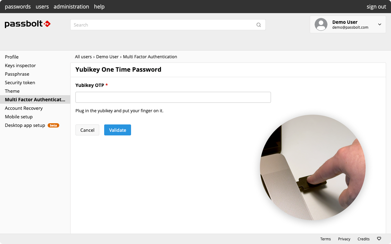

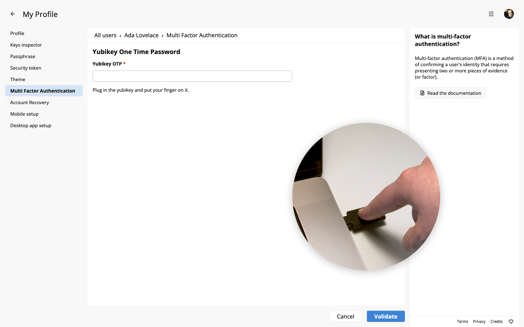

Setup YubiKey as a user
To setup YubiKey as multi-factor authentication method, navigate to the multi-factor authentication user settings page: Avatar > Profil > Multi Factor Authentication. Select the provider "YubiKey OTP" to continue.
The next step will require you to plug your YubiKey and touch it to release a Yubico OTP. Then click on "Validate" to ensure it functions correctly and complete the setup.

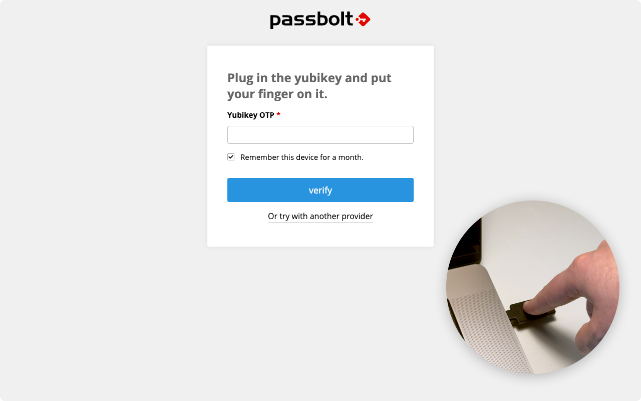

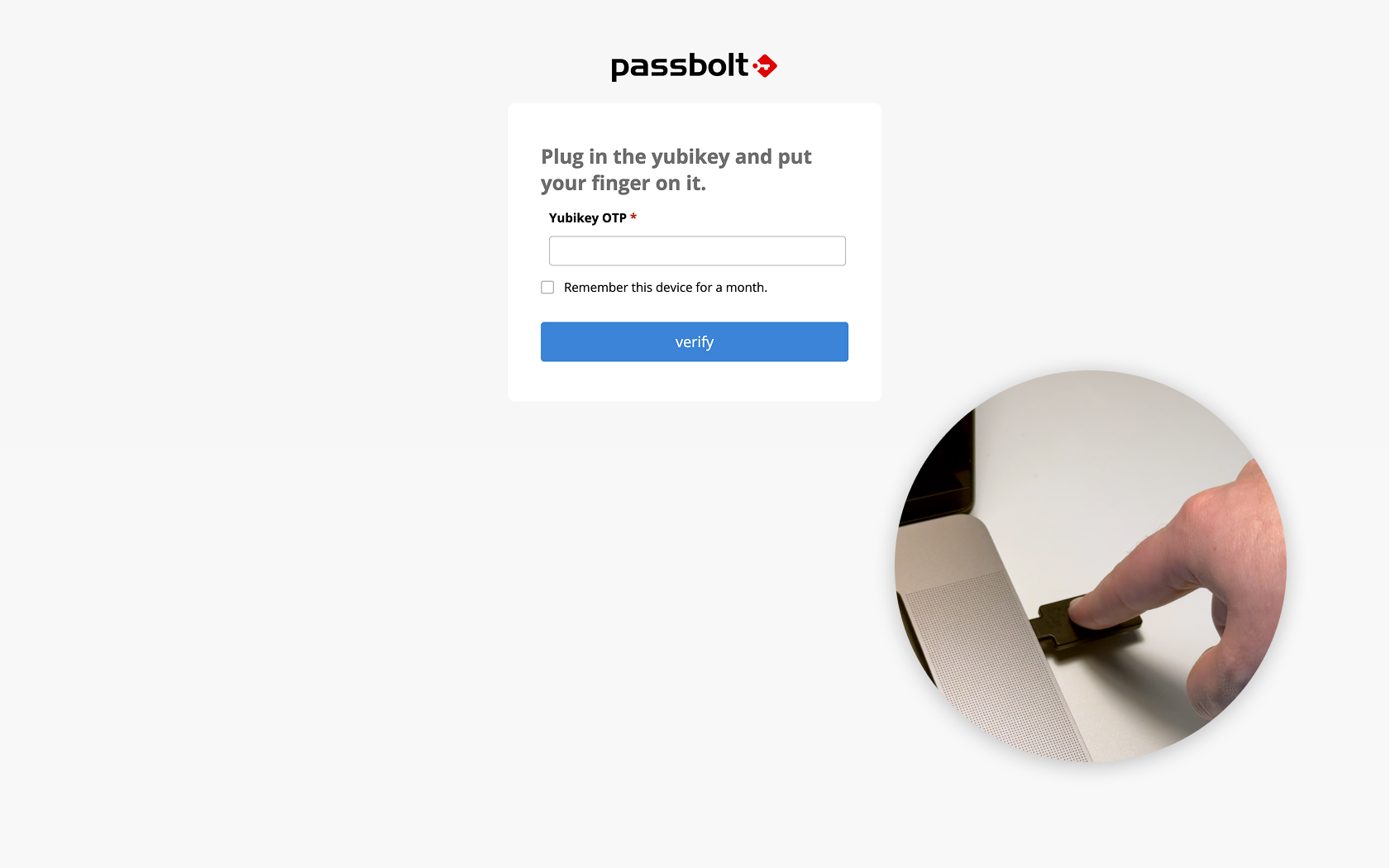

Authenticate with YubiKey
After setting up YubiKey, each time you sign-in to Passbolt, you'll be prompted to plug your device and touch it to release a Yubico OTP. Additionally, if permitted by the "Multi-factor Authentication Policy", passbolt can remember your MFA authentication for a month.
