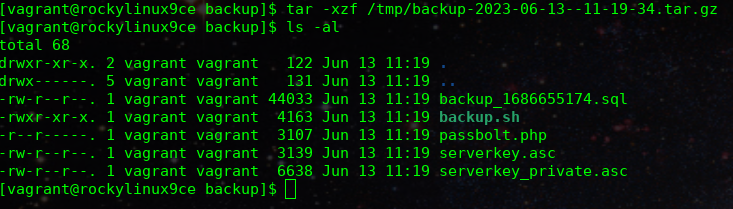

Voila! You should now have the backup tar file in the directory that you specified. Unpack it and check that all the files you expected have been included. You can do this by running the command below:
tar -xzf /<Backup Dir>/<Backup File>.tar.gz
ls -al
It should return something like this:
