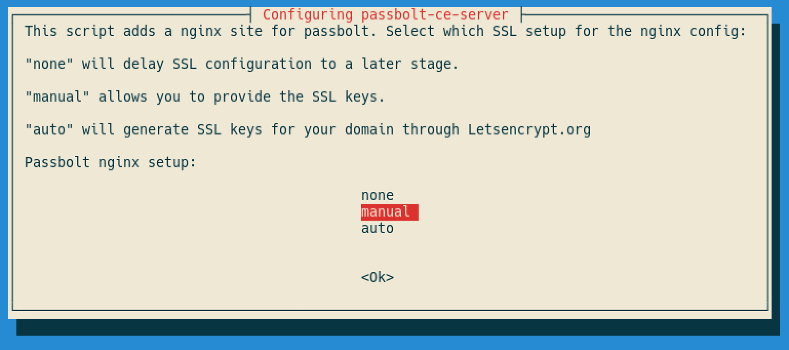

Choose 'manual' for the TLS (SSL) setup method:
SSL method selection
fig. SSL method selection

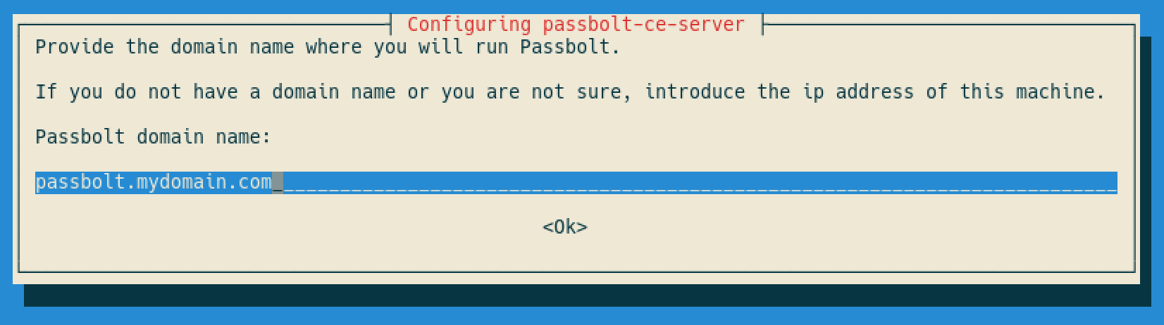

Provide the domain name you plan to use for your passbolt server. On this example and as we are using a self-signed certificate the domain name is not as important as if you are planning to use a proper TLS (SSL) certificate. In the later scenario DNS domain name and TLS (SSL) domain name must match.
Domain for nginx setup
fig. Domain for nginx setup

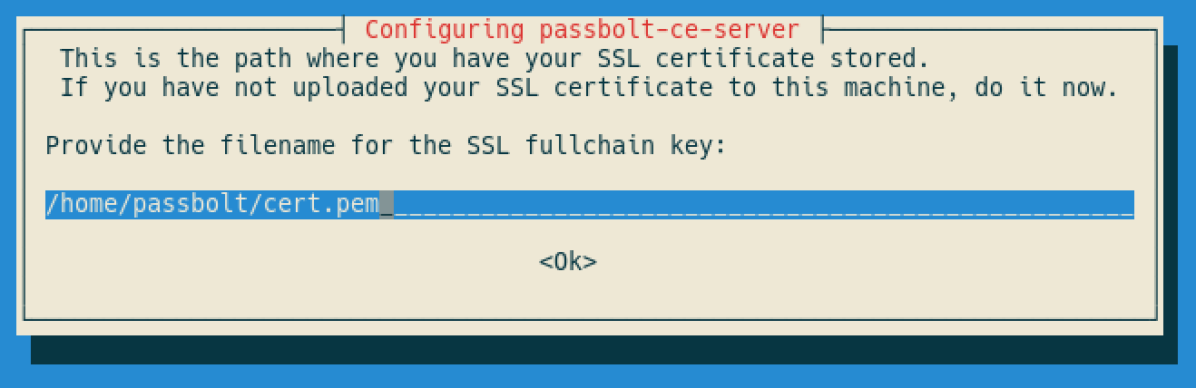

Provide the full path of the TLS (SSL) certificate you created on previous steps: cert.pem
SSL certificate path
fig. SSL certificate path

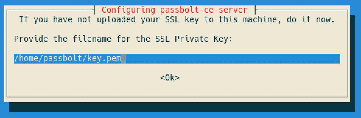

Now provide the full path of the TLS (SSL) key: key.pem
The certificate's private key should not be passphrase-protected so that the web server can read it.
SSL private key path
fig. SSL private key path
